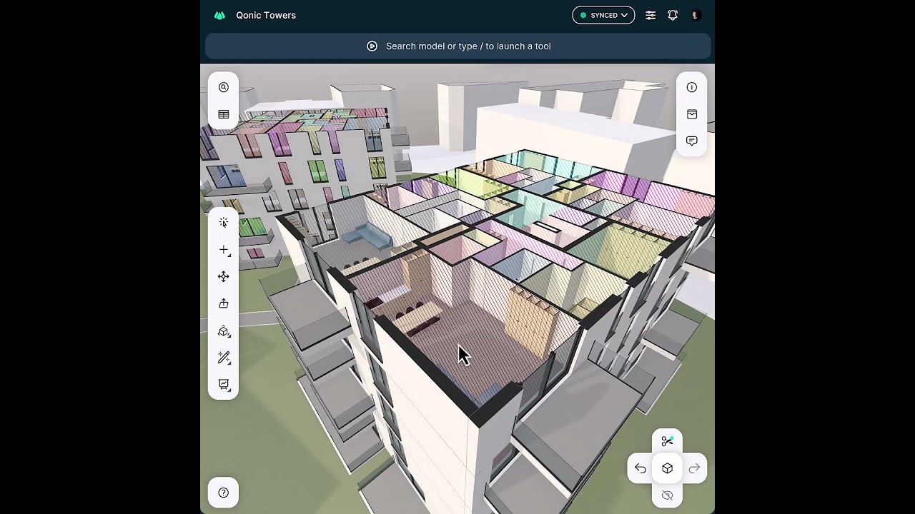

It’s been a busy few weeks, after receiving the openBIM Award in Berlin for Qonic Intelligence, and now we’re back with a new release packed with improvements. This update brings smoother modelling, smarter coordination and a stronger connection with Revit.
Want to see it in practice? Check out this month’s release video:

Awesome stuff, as always! What does a door or window family turn into, after it’s been stretched in Qonic and synced back to Revit? I imagine stretching might easily conflict with constraints defined in the Revit family, so it would seem difficult to turn in back into an instance of the original family definition.
Thanks! Great question @Michael_Hasse and you’re absolutely right that this is a tricky part of Revit interoperability.
When a door or window is stretched in Qonic, we try to keep the original Revit family wherever possible. However, if the geometric change goes beyond what the original family allows (for example, if the family has constraints or formulas that would be violated by the new size), Qonic will automatically create a new Revit family type based on that instance.
So in short:
  • If the change fits within the family’s allowed parameters, the same Revit family is retained and only the instance parameters are updated.
  • If the change alters the geometry beyond those limits, Qonic generates a new family specific to that object, so the original family remains untouched and consistent for other instances.
This ensures you can safely edit and sync without breaking constraints or dependencies in Revit. Feel free to put it to the test yourself! We look forward to your findings and any further feedback on our bidirectional sync.
